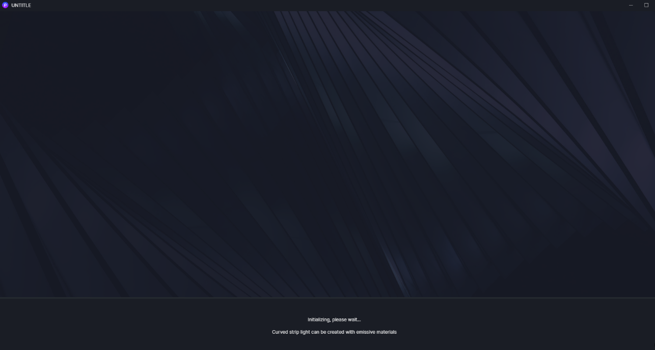

Why can't I open D5/it remain stuck in initializing?
Modified on Sun, 27 Apr, 2025 at 4:37 AM
Hello, when encountering this issue, please test yourself first to check if you can open the empty/demo scene normally.
Please note: After updating D5 or driver version, it takes 5-7min to load the file for the first time when you open it, so please be patient for a while.
