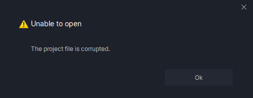

Why can't the file be opened, prompting that the project file is corrupted?

Hello, this issue is most likely caused by not copying the entire project folder during transfer, and only copying the .drs file. You must copy (not cut) the complete scene folder—that is, the entire folder containing the .drs file—to the new storage location. Then, launch D5 by double-clicking the .drs file from the new path.
Please note that a standalone .drs file cannot be opened because it lacks the necessary project data.
