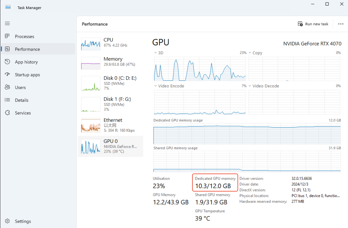

  • Please monitor the Vram and Ram usage when running this specific scene (open Task Manager - Performance)
If the dedicated GPU memory usage has reached 80% and above when running the current scene, the core advantage of the graphics card will decrease and be in an unstable state (D5 may lag/render slower/pop-up error/crash/flashback, etc.).
