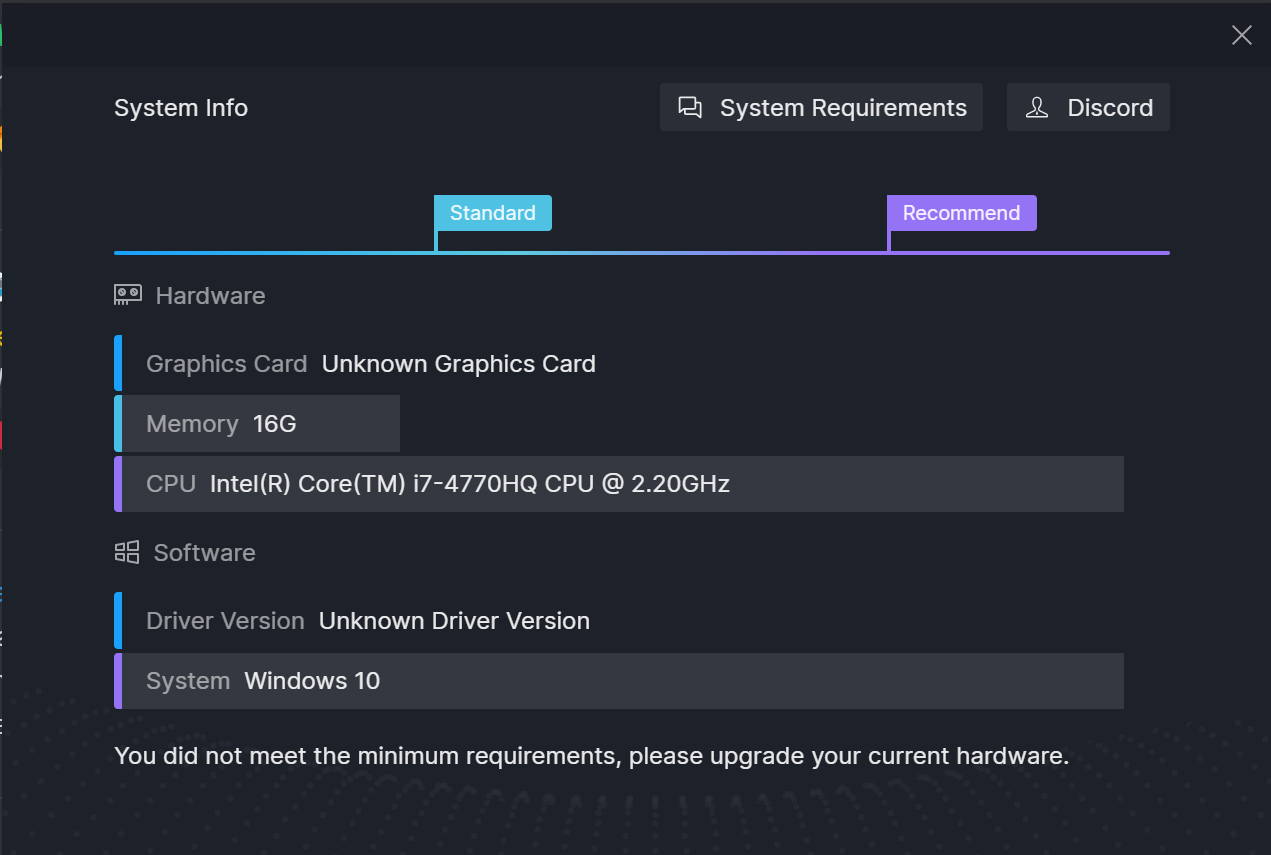

- The graphics card does not meet the requirements to run D5.
In the System Info, the 'Graphics Card' and 'Driver Version' columns are showing as 'Unknown'. This typically indicates that your current graphics card may not be fully compatible with D5 Render. Upgrading to a supported graphics card is recommended for optimal performance.

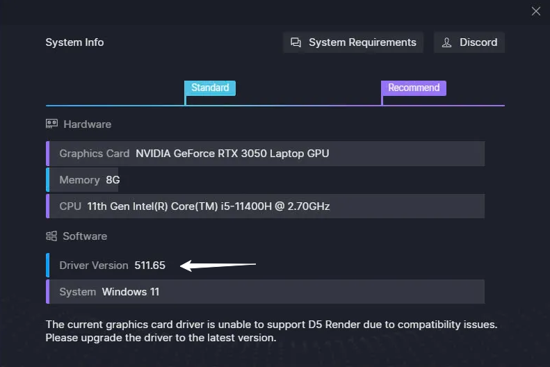

In your System Info interface, the Driver Version column not having a grey fill suggests a problem with your current driver. Updating your graphics card driver to at least version 527.27 is necessary for D5 Render to function normally.
Please refer to: How to view and upgrade graphics card driver? | User Manual

  • If you have two graphics cards in your device, one of which is a discrete graphics card supported by D5, but D5 only recognizes the other unsupported graphics card. Please try to disable the other integrated graphics card in ‘Device Manager’ to check the result.
  • If your graphics card is supported by D5, but still displays ‘Unknown Graphics Card’. Please download and run Benchmark Tool to check the result: Benchmark Result. If it displays the data normally, your graphics card may have errors that prevent it from being recognized. Please check if the graphics card is installed correctly and re-insert it.
