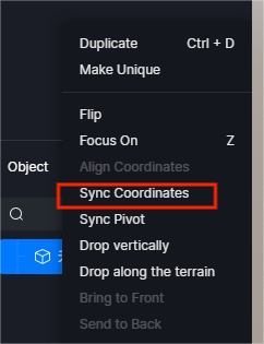

If the overall range (bounding box) of the model is changed after replacement, the model will be misaligned. This will only happen if the model is imported directly. To avoid this problem, please make sure you perform the ‘Sync Coordinates’ after the first import of the model.
